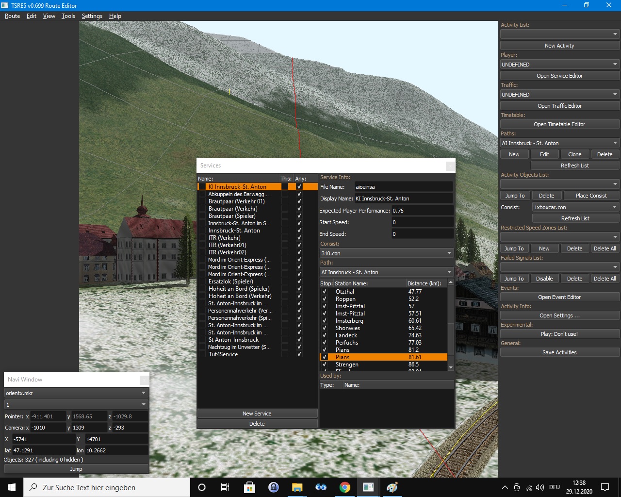

The Service-Editor is showing some stations two times in the list.
I have open the MSTS Original Route Europe2 in the TSRE5 V. 0699.1.exe and started in the activity-Editor the service-Editor
EUROPA 2.jpg (428.26 KiB) Viewed 112226 times
Now you can see in the Origialservice "KI Insbruck-St.Anton" under
Stop: Station Name:
Pians and Imst- Pitztal
twice in the List?
In MSTS Activity-Edtor all is o.k.
Can you please have a Look on it?

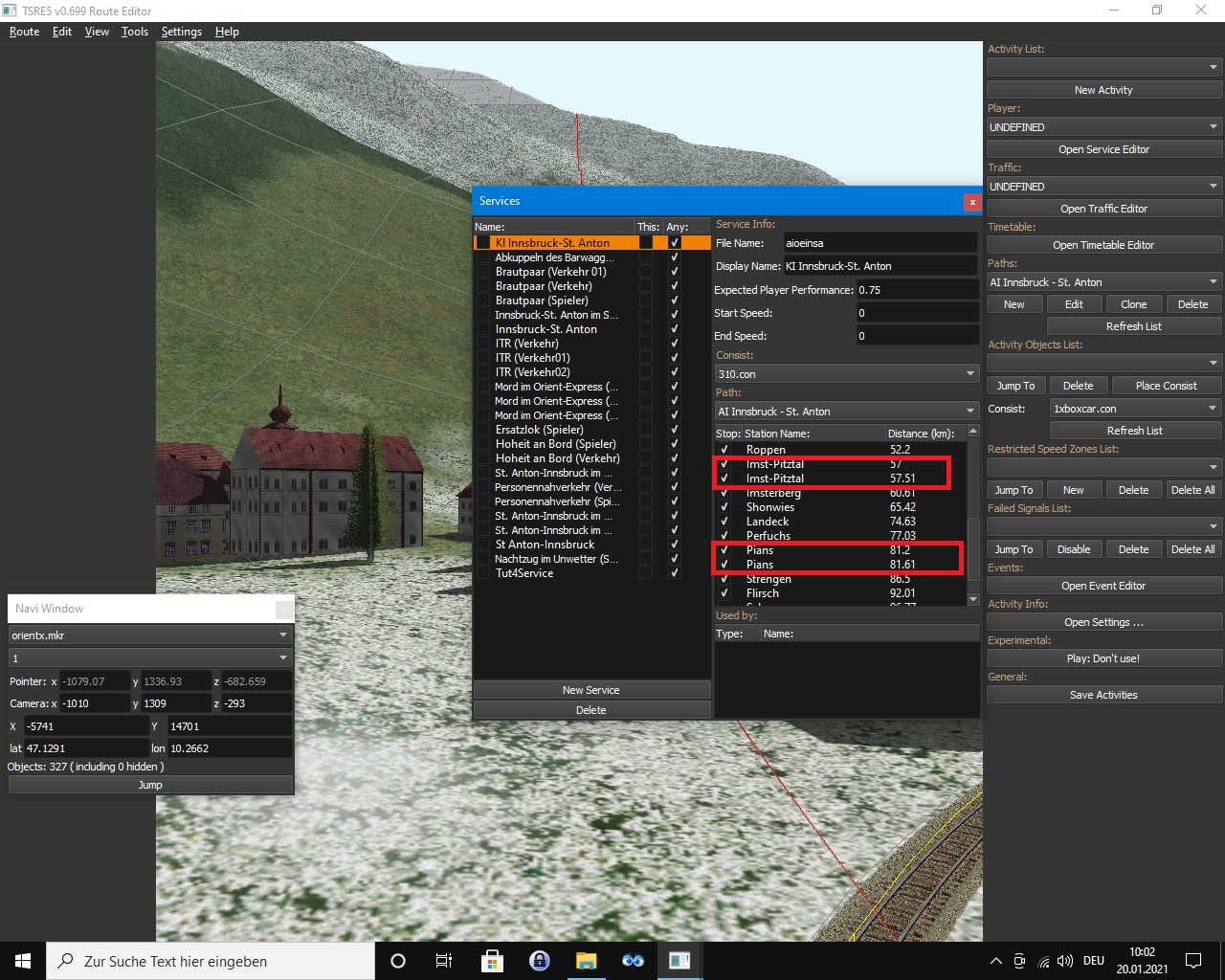

Posted: 20 Jan 2021, 09:19
by eugenR
Hello Goku,
It would be glad, if you could have a look at this problem.
It persist again and the hint for the Testroute is not working in every case.
I think, the Problem occurs on singletrack-routes and there if in the Passing-Track there is no switch to a dead-end-Track
The Problem occours also in the MSTS-Original-Route EUROPE2, as example in the Service "KI Innsbruck- St.Anton" at the Stations Pians and Imst-Pitztal
