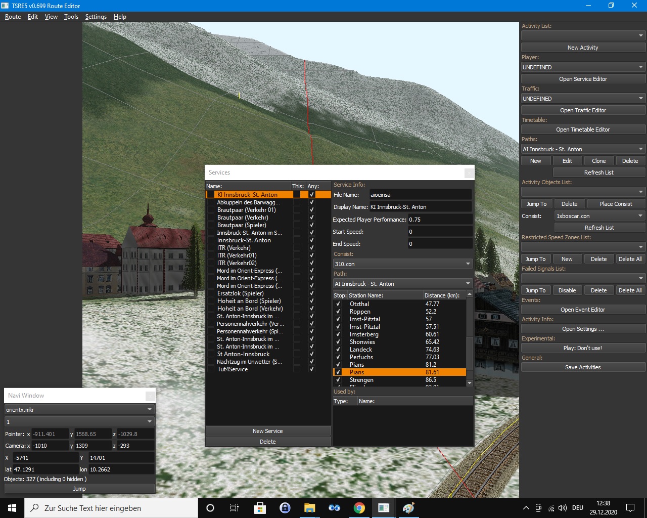

The Service-Editor is showing some stations two times in the list.
I have open the MSTS Original Route Europe2 in the TSRE5 V. 0699.1.exe and started in the activity-Editor the service-Editor
EUROPA 2.jpg (428.26 KiB) Viewed 111810 times
Now you can see in the Origialservice "KI Insbruck-St.Anton" under
Stop: Station Name:
Pians and Imst- Pitztal
twice in the List?
In MSTS Activity-Edtor all is o.k.
Can you please have a Look on it?

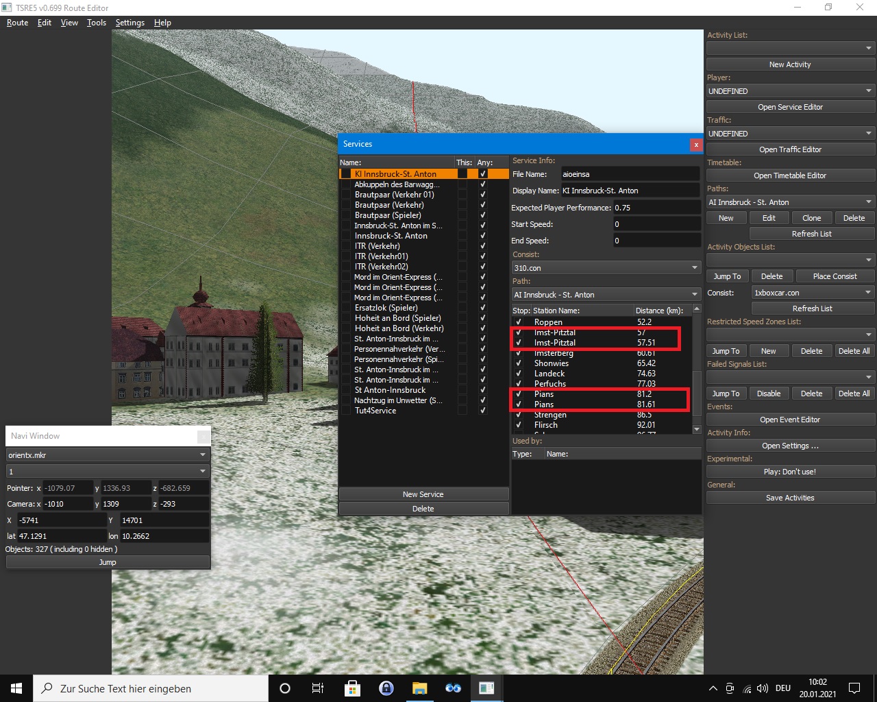

That's because the train paths has two reverse points at the same station. This was done in MSTS so that an AI train could overtake the player's train.
It may also be that the train using these paths performs a maneuver to couple wagons.

The reason for the double station stops is not the TSRE, but faulty route points in the middle of the platformmarkers. Many services of the Europe2 route are not used at all. So also the aioeinsa.srv with the name "KI Innsbruck-St. Anton." I had to add this manually, because TrainStore did not find an associated activity.
After a cursory check of the rest of the Europe2 Route paths, it can be said that several paths are loaded with these route points between the platform markers and these were probably inserted intentionally.
Now I can't tell if TSRE should treat these route points the same as MSTS, or if it's not easy to create a new path that doesn't contain these route points.
Greetings Jan

Probably it is a BUG in the TSRE after all.
In Pians, the error was solved after reinstalling the platform markers.
In Imst-Pitztal, only the new integration of all switches led to a positive result.
Original:
After edit the route:
