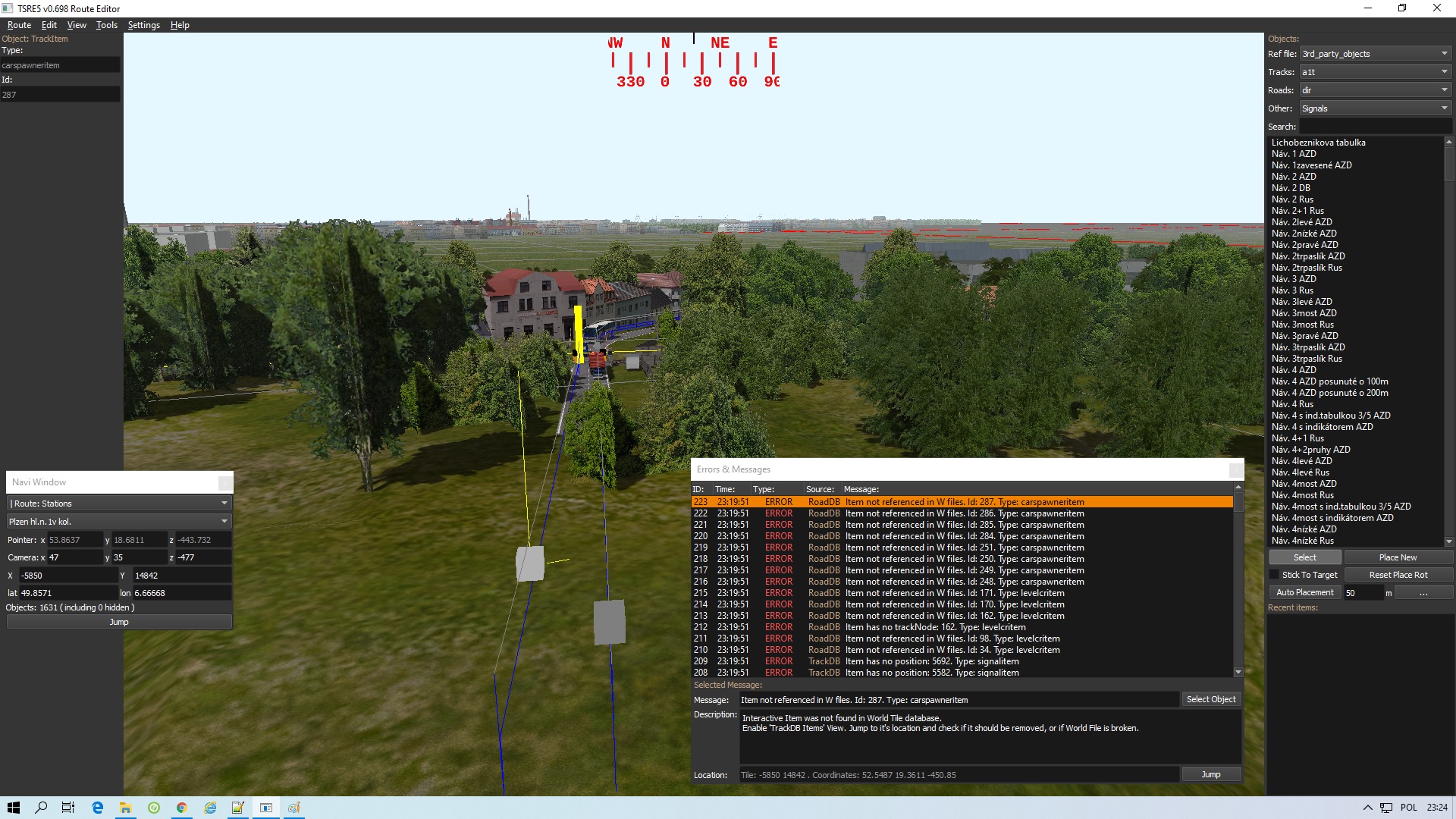

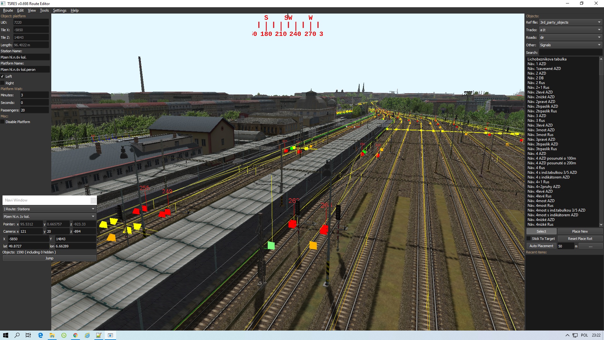

Posted: 04 May 2020, 21:41
by m61
Trat 183.jpg (651.47 KiB) Viewed 25096 times
Trat 183 error1.jpg (500.75 KiB) Viewed 25096 times
