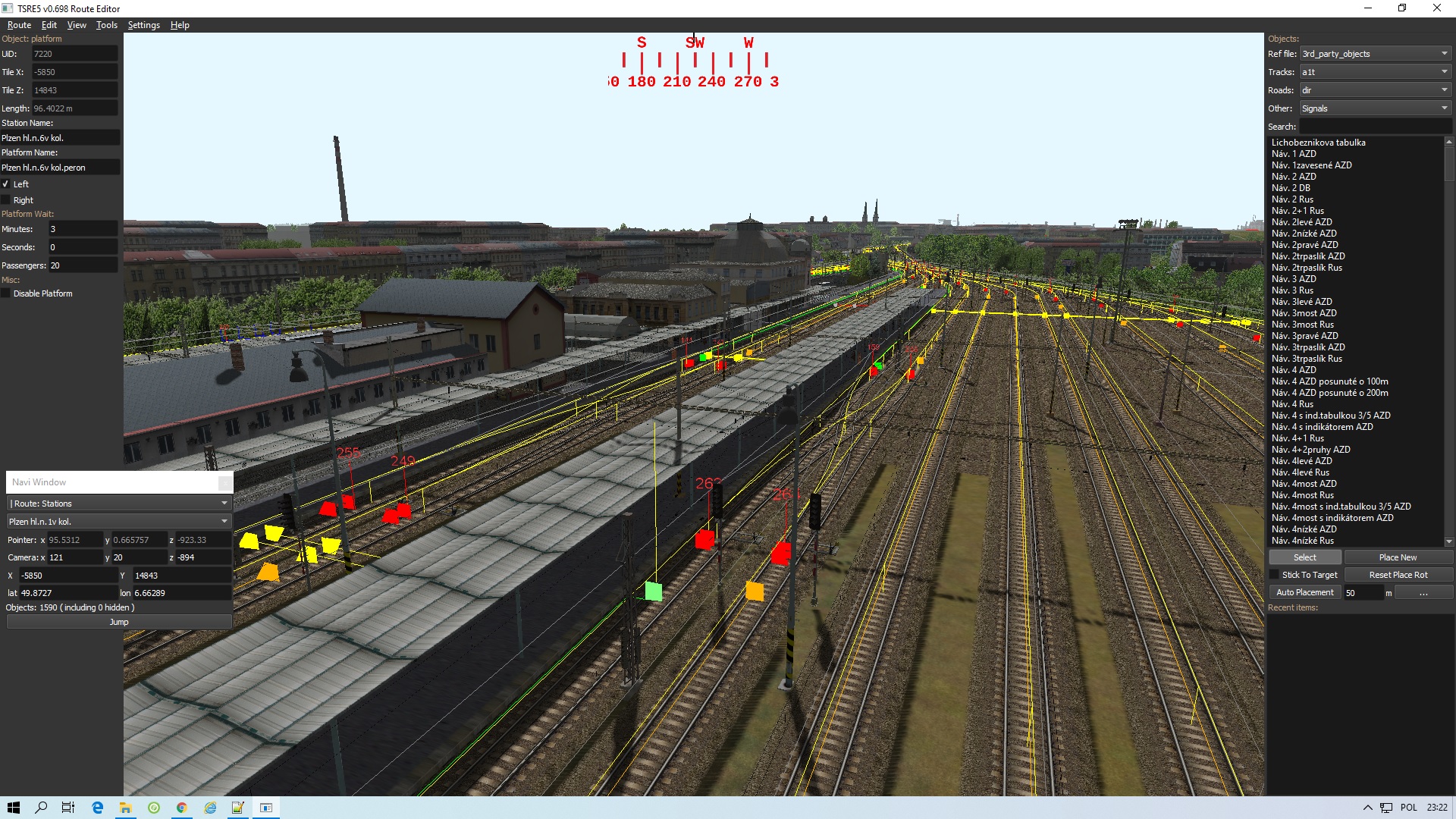

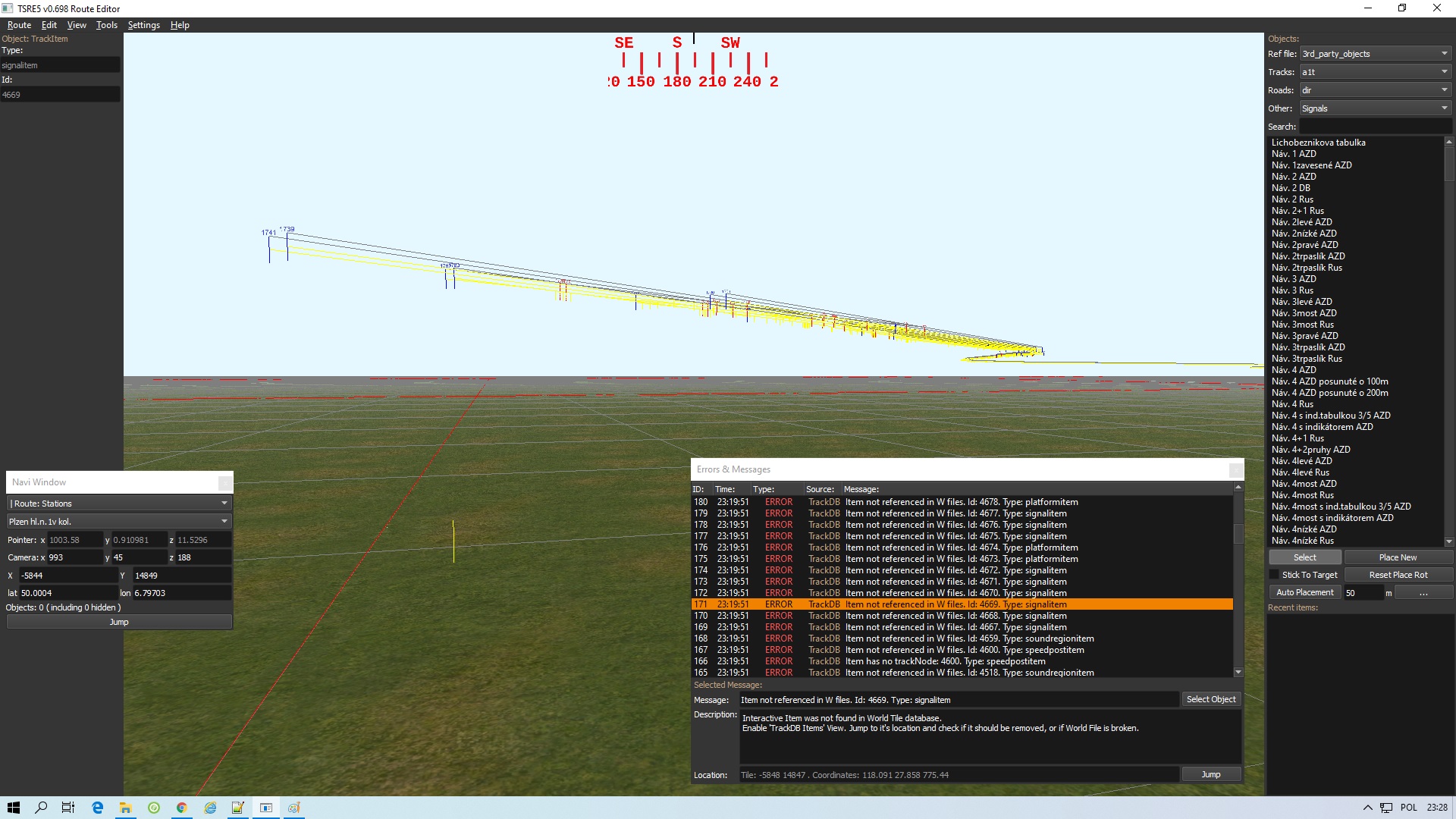

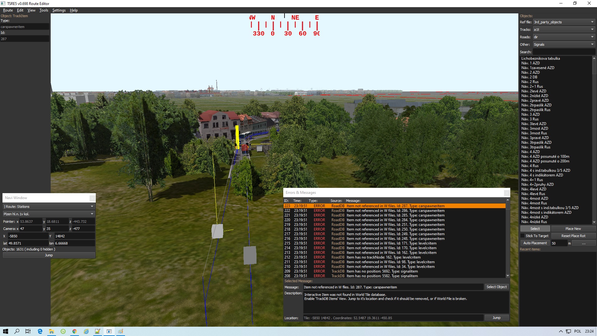

Trat 183.jpg (651.47 KiB) Viewed 30415 times
Trat 183 error1.jpg (500.75 KiB) Viewed 30415 times
