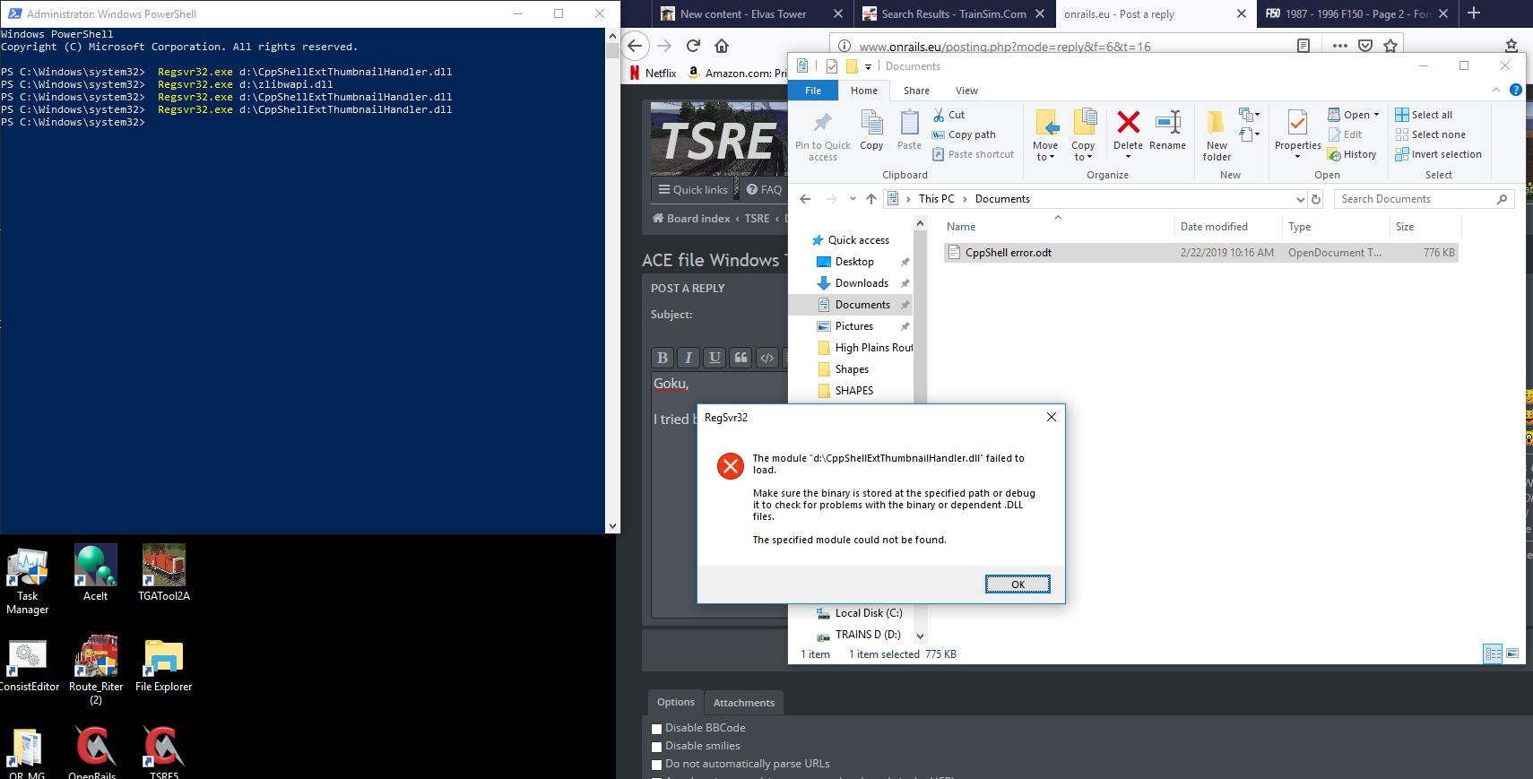

Has anybody besides me had trouble trying to get this to work in Windows 10/64?
I even had my son who is in his last quarter in college for a computer engineering degree try.
We tried the command prompt and powershell. Both elevated to admin.
Is this .dll for Windows 7 or is it supposed to work in 10 also? 32 or 64 bit?

Posted: 22 Feb 2019, 21:18
by Switch Tender
Goku,
I tried both CMD and Powershell as administrator.
CppShell Error.jpg (160.63 KiB) Viewed 28420 times
I've tried at least half a dozen times without luck.
Randy

Re: ACE file Windows Thumbnails
Posted: 12 Mar 2019, 12:13
by viaEstrecha
Switch Tender wrote: 22 Feb 2019, 21:18
Randy
In Powershell, make sure you change to the folder where you've put the .dll files, before executing the registration command. In my case, I put them in c:\msts\utils, then did this in Powershell (Windows10 Pro, 64 bit):
