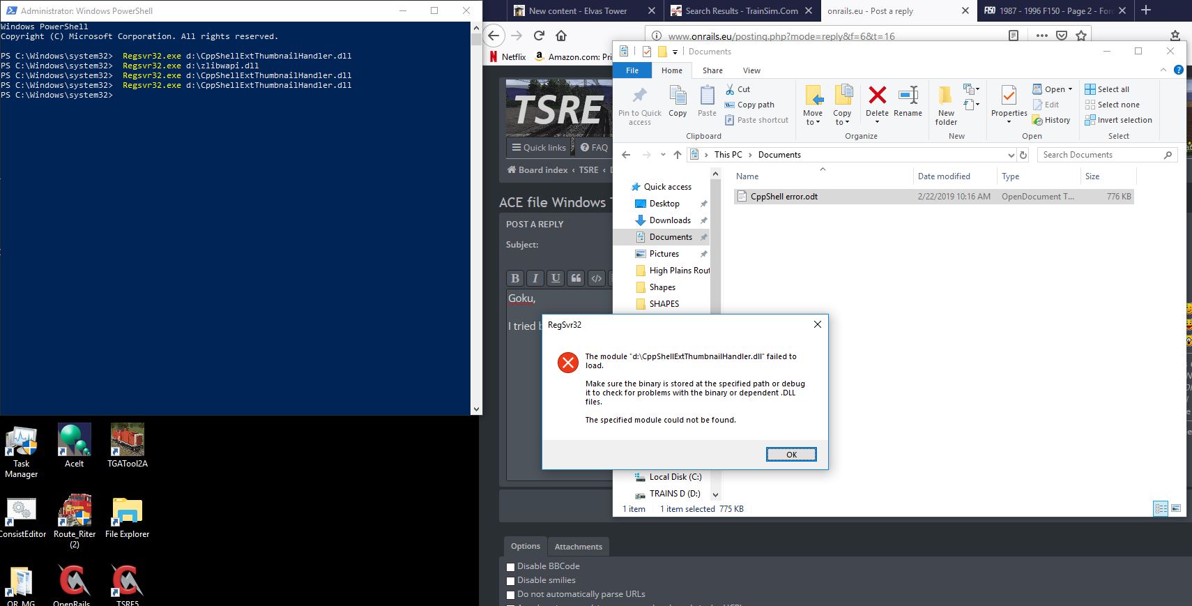

Has anybody besides me had trouble trying to get this to work in Windows 10/64?
I even had my son who is in his last quarter in college for a computer engineering degree try.
We tried the command prompt and powershell. Both elevated to admin.
Is this .dll for Windows 7 or is it supposed to work in 10 also? 32 or 64 bit?
Goku, TSRE is an amazing tool. Thank you.
Randy

Switch Tender wrote: 22 Feb 2019, 16:02Both elevated to admin.
Yes. You have to do it as administrator. Only 64 bit.

Goku,
I tried both CMD and Powershell as administrator.
CppShell Error.jpg (160.63 KiB) Viewed 28394 times
I've tried at least half a dozen times without luck.
Randy

Switch Tender wrote: 22 Feb 2019, 21:18
Randy
In Powershell, make sure you change to the folder where you've put the .dll files, before executing the registration command. In my case, I put them in c:\msts\utils, then did this in Powershell (Windows10 Pro, 64 bit):

I had the same problem as Switch Tender and I used this to register the .dll on Windows 7.
Before you start UAC must be disabled.
1.Click Start, Run or press and hold the Windows key then press R.
2.Type REGSVR32 in the Run line
3.Press the Space button on the keyboard
4.From the file location of the .dll file, select/highlight the pertinent .dll file
5.Drag and drop the selected/highlighted .dll file into the Run line after the space. Note: Be sure to include the quotation marks if the path contains any spaces.
6.Click OK
The article can be read at: https://kb.blackbaud.com/articles/Article/48280
