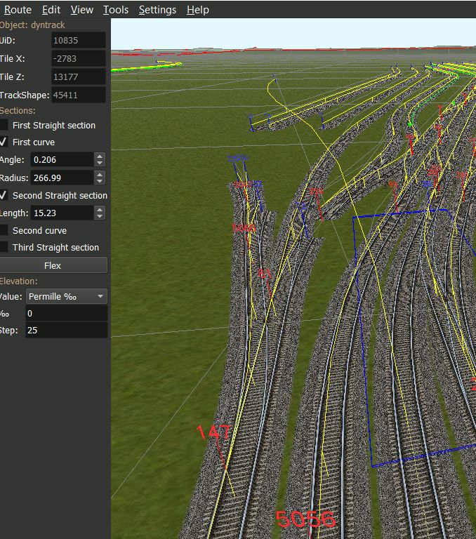

Hello,

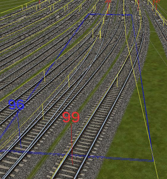

Please refer to the images attached. After placing dynamic tracks, Yellow line is not following the track placed. Even if you remove tbd and add again yellow line is not following tracks. The only solution I know is to use Hacks -> remove tbd vector but unfortunately this method is also not working. So can anyone please guide me ? how to solve this error ?
							Error in the TBD of Dynamic tracks

Yes, but unfortunately its not working.
						You have a strange yellow line with no trackshape which terminate in the upper center of the second screen. Try to remove her.
- remove from TDB the adjacent(s) trackpiece(s) (Z key)
- put a trackpiece at the end of the yellow line
- use the HACKS fonction (sometimes click many times)
- after the yellow line removed, delete the trackpiece
I think this has happened because you have placed the dynamic track and adjusted it to follow the path of yellow line. Then you have deselected it, this puts the shape into the tdb file and displays the yellow line. You have then reselected it, and without pressing Z to remove the track from the tdb file, you have changed the shape of the dynamic track.
Hopefully there is an easy solution, but just in case of problems:
First you should create a backup copy of your route.
Then select the dynamic track, and make a note of the lengths of straight and the curves.
Then delete the dynamic track. This should remove both the track and the unwanted yellow line.
Finally place a new section of dynamic track using the sizes noted above.
If things go wrong you can return to your route backup.

Agree with Garry.  One thing I've noticed is that the TDB geometry and positions seem to be cached for lack of a better term, and sometimes tracks don't line up or snap correctly.
Deleting, saving, closing, re-opening and rebuilding with a new piece seems to fix that.

First of all Thank you jeanmarc, Garry and eolesen for your reply and suggestions but problem in this case is complicated and I am unable to convey it through the words. I am attaching one video please refer to that and have your say. At the end of this video you can notice that TSRE is closing automatically as I tried to add TBD line again using Z.

Garry, Even after removing track items and tbd results are same. Also I have tried by removing all TBD near by and reconstructing it but unfortunately problem continues.
jeanmarc, Even if you try to place dynamic track starting from another end, Results are same.
And TSRE keep on crashing when I try to add TBD to dynamic track again.
