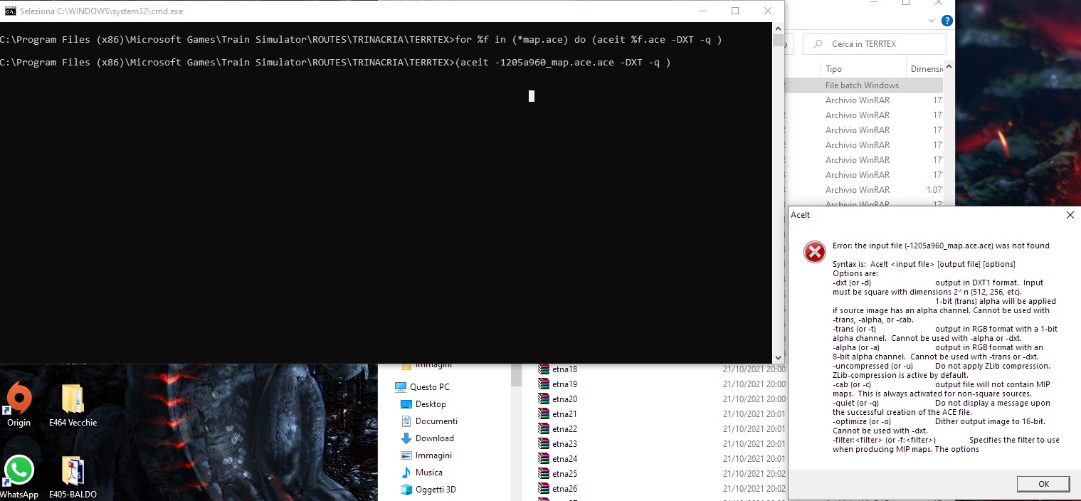

I have done a test but the result is this:
Ho i can resolve it? i entered the script you attached in the batch file!
