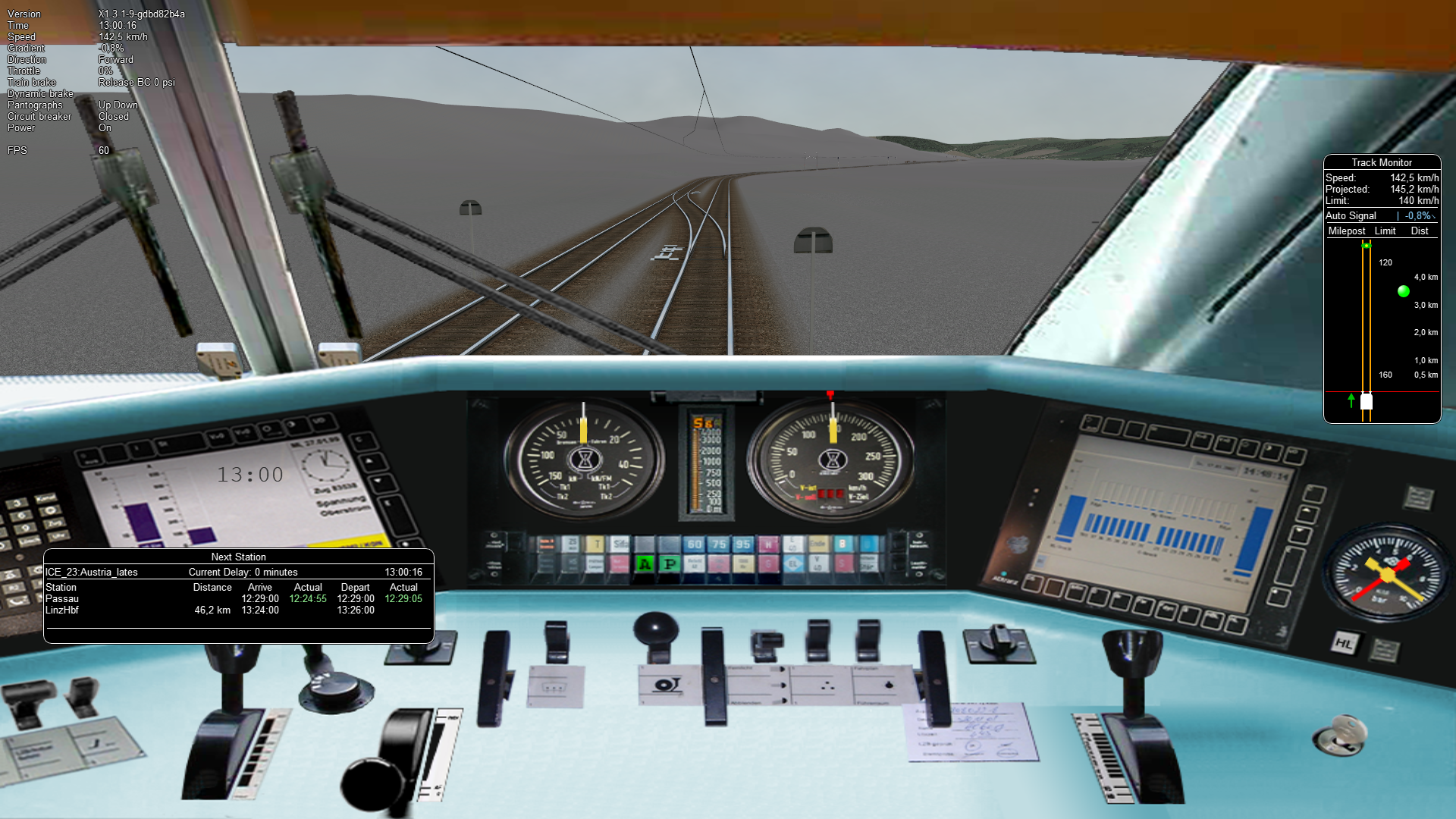

Hi,
some tiles covered with satellite image look perfect within TRSE but in ORTS they are completely gray. Please help!
It would be nice to see more details.
hannes44
Posts: 29
Joined: 27 Jan 2019, 14:23
Picture enclosed. Could it be that used textures are not unloaded during game, because the problem increases with game time. If so, this is the wrong forum, and I have to ask an ORTS help-forum. Sorry for that!
Open Rails 2019-01-27 04-47-03.png (2.13 MiB) Viewed 12922 times
It would be nice to see openrails log. Unlike TSRE log, there is a lot of useful information.
