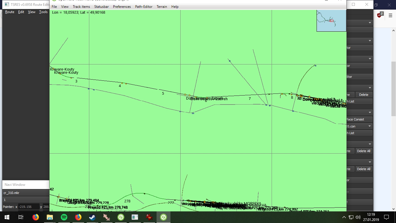

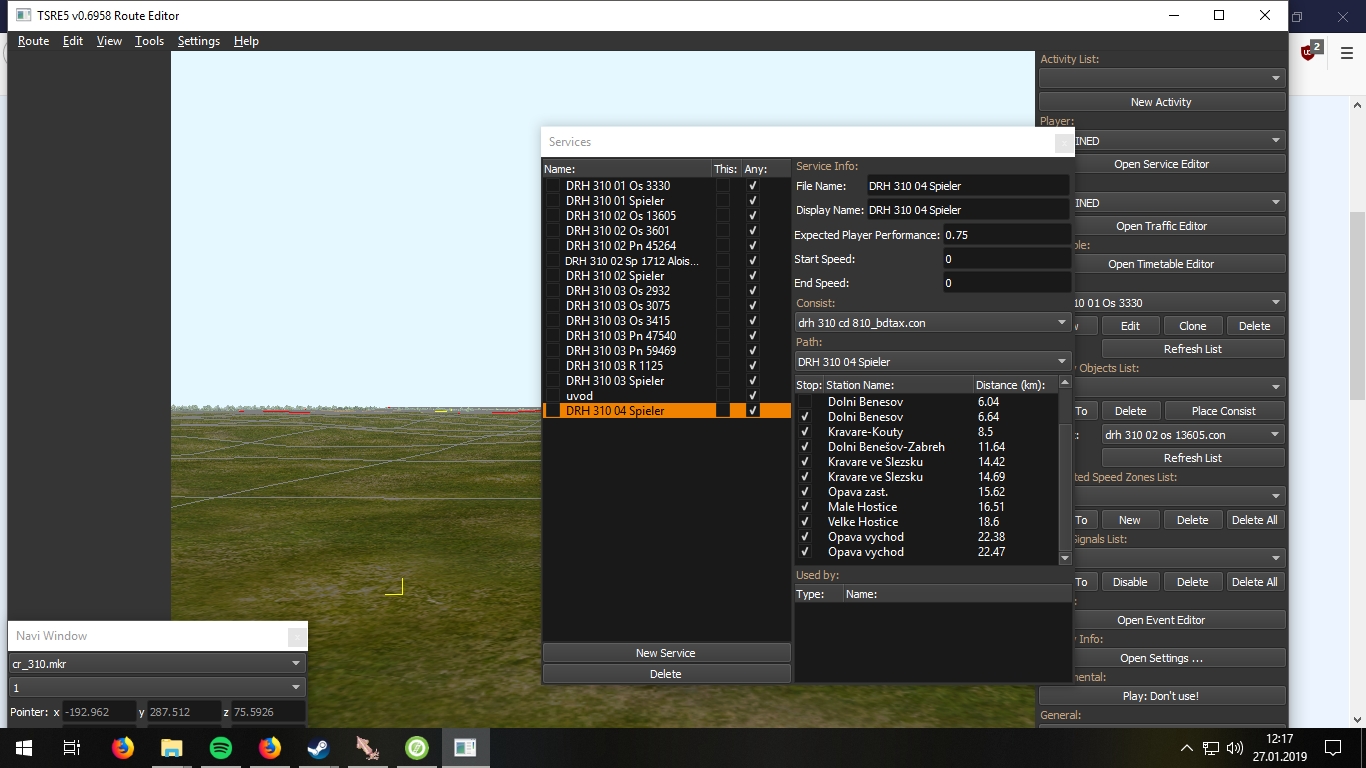

Unfortunately I have a problem with timetable creation on many Routes in Activity Mode. In many cases the Services Editor shows the stops for the Service in the wrong sequence. Here is an example for the Trat310 by Jacek:
The supposed stop sequence would be Dolni Benesov - Dolni Benesov Zabreh - Kravare-Kouty
But during service creation this sequence gets mixed up with Dolni Benesov - Kravare-Kouty -Dolni Benesov Zabreh
I also have this problem with the service creation in other routes, for example Oberlausitzbahn, Pro Train 22 and Liberec - Tanvald.
Does anyone know a solution to get the stops in order, I would be very grateful if anyone has a good trick, because otherwise the creation of activities works very well for me with TSRE.

Thanks. Your example may be helpful.
Probably TSRE list the stations on track vector always using only default order.
Bug found and fixed. (I hope so)
Available in a next update.
