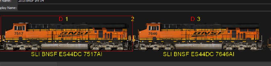

Is it (or will it be possible) to replace missing rolling stock with the TRSE Consist editor? On the image below it shows I am missing the unit with the yellow 2. It seems I can't delete or replace it. Or am I overlooking someting?

In the 'View' menu select 'Consists Units'
Select the composition you wish to modify and the list of all the vehicles that make up the consist appears in the 'Consists Units' panel.
Select the one you want to delete and press the 'Delete' button
To replace, after removing, select a new vehicle, put it in the consists and move it to the desired position

Thank you very much for explaining this. Works perfect and saves a lot of time!
