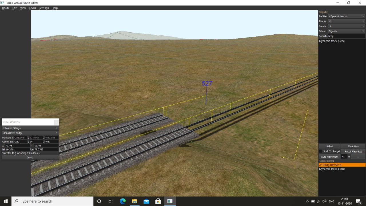

Initially I want to Place dynamic Track but By mistakely i changed length of dynamic track After pressing Z and Saved the route . Now this happen (Refer Attached photo ) I can't delete yellow line . Plz Guide me what to do now and how to solve this problem ?????
Use Z to remove from TDB on a second good track after this one and then select first good track and use Hacks -> remove tdb vector.

Problem Solved , Thank You Sir
