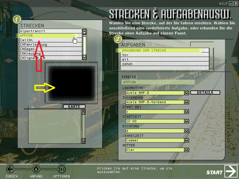

I have made a Testroute with TSRE5 to test a new Signalpacket.
To control this new Packet also in MSTS I have tried to load this testroute in MSTS.
MSTS has crashed by select by mouse the route in the Route-selection-window (red flash).
This is so with all Routes produced by TSRE5.
I have found: In the Main-Folder is missing the File Graphic.ace
If I select by mouse the Route "CallOn", a TSRE5 produced route (red flash), MSTS is crashing
because the file "graphic.ace" defined in the File <RouteName>.trk is missing in the Main-Folder of the Route
MSTS need it for the small window (yellow flash)
MSTSRE is copying the file Template.ace from the Folder TEMPLATE, rename it to the <RouteName>.ace and is placing this file in the MainFolder of the new Route. In the *.trk-file is then written
graphic ( <RouteName>.ace )
Can you please have a look on this?

That file can be created by you and put at the root of the path.
It appeared that in an installation for Open Rails, the TEMPLATE folder does not exist

Of couse i have this done !
But to avoid craches by other users it would be nice, if TSRE5 would produce this File automatically.

Since OR does not need that file to function, and it is easy to create that file by hand, I prefer that Goku use his energy in solving other problems or in advancing on pending points.
Forgive my selfishness.
I apologize for my English of translator
Thank you for finding a solution for this problem. It is an easy fix, it will be fixed when I'll find some time for TSRE.
