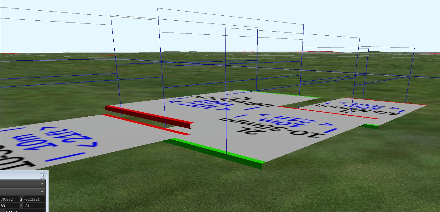

When the tsection.dat specification puts the path above the shape you cannot place shapes so they snap together in a smooth line. Instead the new shape's origin point is placed where the path is located which produces a stair step like assembly. The use of snap to selected does not appear to make any difference in this situation.
TSRE Bug.jpg (126.69 KiB) Viewed 63463 times
Here is the tsection spec:
TrackShape ( 25524
FileName ( gR_All_2Lb_21f_010m.s )
NumPaths ( 2 )
Sectionidx ( 1 -1.6764 0.2 0 0 0 )
Sectionidx ( 1 1.6764 0.2 0 0 0 )
RoadShape ( )
The path is supposed to be 0.2m above the origin point because the shape itself is located 0.2m above the origin point. The reason for the lift is the road is arched using a 2% slope outside of the two center lines (not shown in the image above).
These shapes are being built as a modular system -- center lanes in one shape, outer lanes in their own shape. That allows for mix and match of appearances, such as center lanes for a streetcar, outer lanes on one street in concrete and in another asphalt. This approach minimizes the number of tsection entries as well as helping to get the total number of models to make down to 1/3 as compared to doing things the traditional way.
The specification for the outer lanes (in their own shape) will put their paths a bit lower (they're on a slope away from the center) and they include the 2% tip so cars will run slightly tipped -- as they do on real roads.
As things are right now I cannot correctly place any of these road shapes.

I don't understand the reason for such shape definition. Don't expect fix in near future.

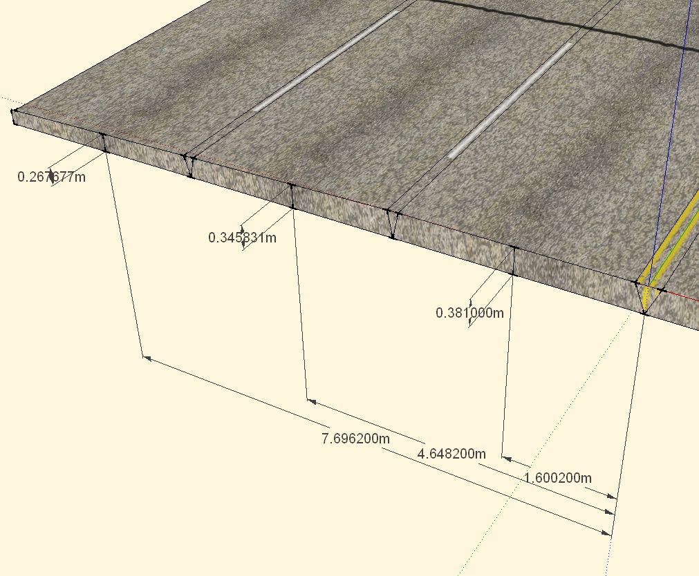

Because the shape of the road is an arch there is a different height for the path in each lane.
I concluded lifting the faces of the center lanes by 0.2m combined with a 2 degree slope outside of the slow lanes will put the gutter of a 6L road on the ground. That means the paths for the slow lanes will be lower than the fast lanes in the center of the road.
I considered simply elevating the center lanes by 0.2m after placement. That would work for the paths in the center but it means the paths in the slower lanes to the outside will be above the surface of the street. IOW the cars will be floating.
Here is the road and it shows the locations of the paths for each lane.
road profile.jpg (126.97 KiB) Viewed 63451 times
As you can see the elevation of each lane is different. W/O dealing with the differences in path height the cars in the slow lane will be floating 11cm above the road. AFAIK the only way to properly define the location of the paths is within the tsection data and to do so exactly as I have done. If the road shapes were placed per their .s file origin points it would all work.

The shapes were originally built as these sort of things have always been built -- road surface at 0,0,0 and a tsection definition to match. They placed normally. I could lift the first one as needed and all of the rest would snap to the correct location.
I then went back to the shapes and raised the faces 0.2, exported them, and edited the tsection data. I don't recall now whether I deleted the original placements before trying to use these or later. What I observed is the placement of the first section in any new location was as expected -- the origin point was on the ground, the faces were elevated. Happy with this I then started to add additional sections. Each additional section was 0,2m higher than the one that was placed before. Place 5 and then next one would be 1m above the ground.
I don't know what is in the code but what it looks like is the code is using the path values in the tsection file instead of the origin point to place these shapes.
