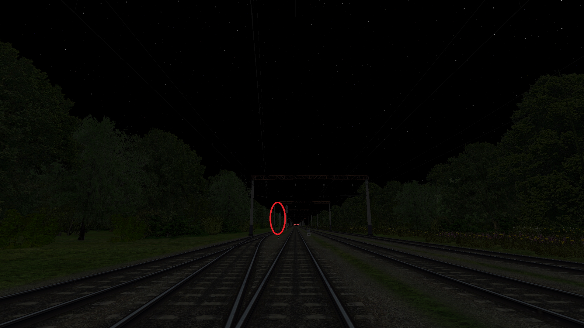

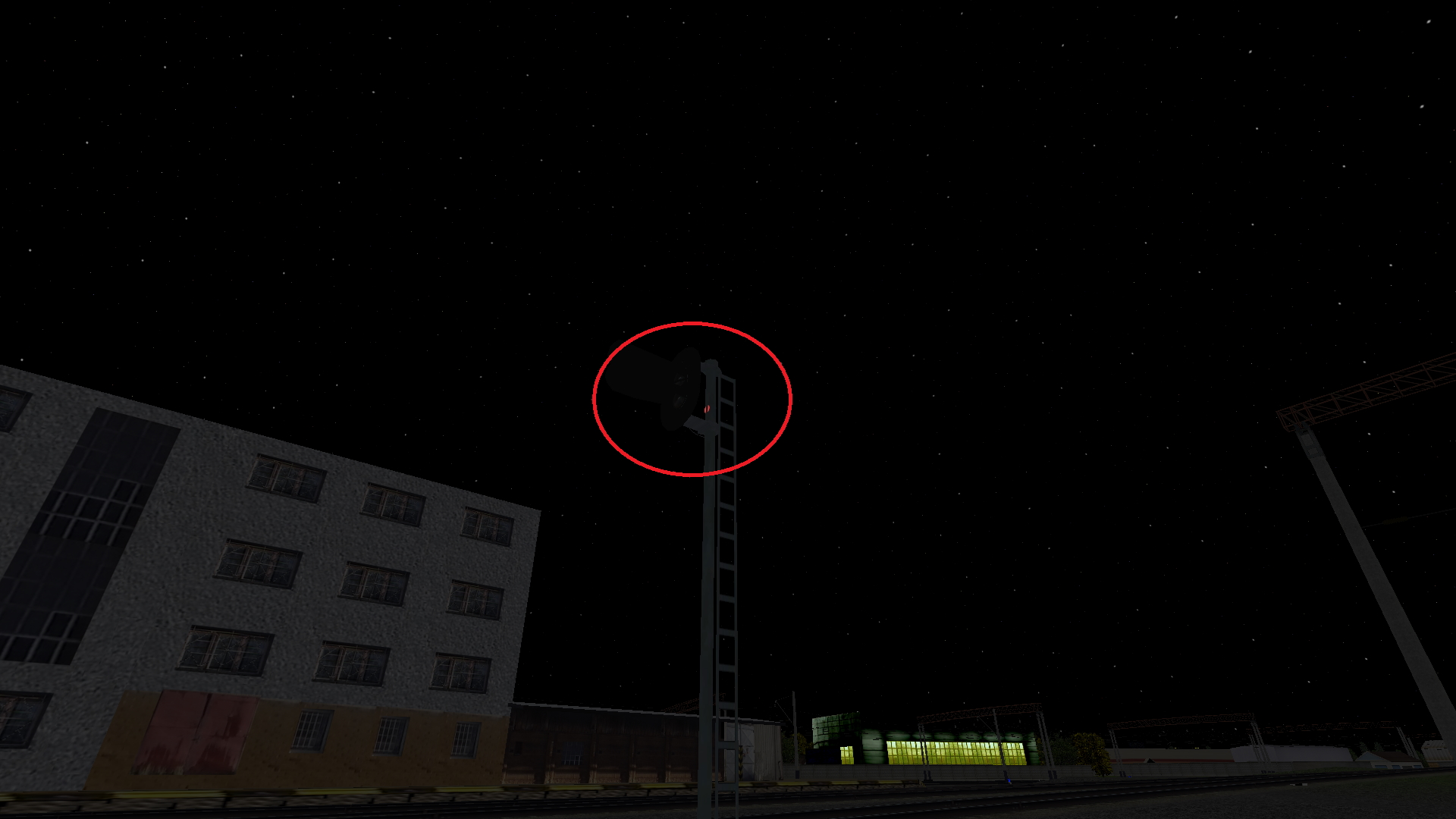

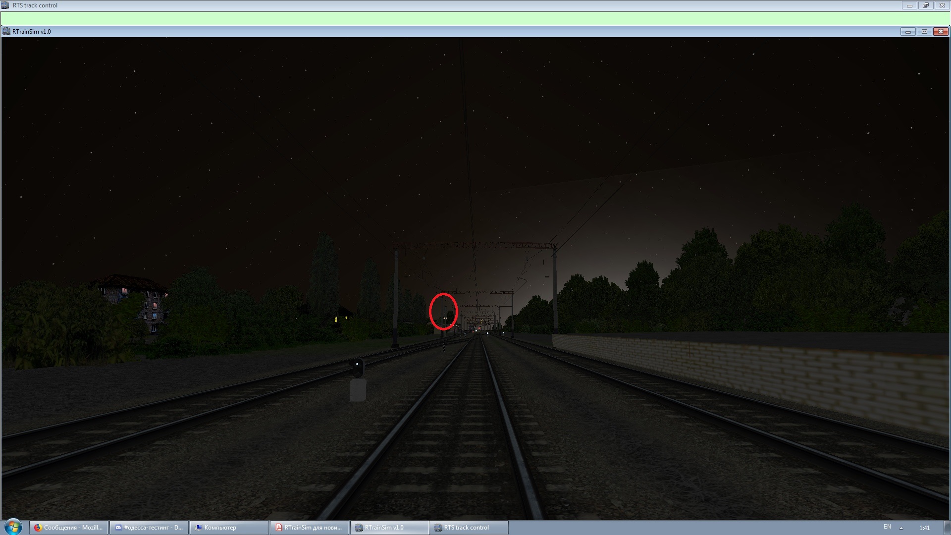

The problem is that when i place signals in TSRE sometimes a graphical bug can appear with some newplaced signals that the lights of that signal "move out". The problem is that a signal itself works good on a dispatcher (proper signal for every route in proper direction) but the lights of the signal are turned in the opposite direction or are hidden inside the signal model — they move out in some way from the signal model, see the screenshots.
The bug can be fixed manually for every signal model using «Reset Rot» on the signal model (even not touching the marker, only the model itself) and «copy-pasting Rot» from the track to the signal model to make the lights be parallel to the track. Or by double-flipping the signal. The issue is that if the signal doesnt have the bug BUT you double-flip it the bug can appear :D
The bug appears only when working in TSRE, not MSRE. This bug is very annoying in RTS when you use the older (and most popular) OpenGL version 25 where the signal light is a texture; when you use the newer verison OpenGL 40 where the signal light is a beam of light there is no such a bug - dont know why. But the bug appears only if you place signals in TSRE and has a certain probability to appear for every signal placed.

Yes, there is a problem, probably with updating trackitem R data in TDB. OR doesn't use it at all, so it was never tested and resolved.

Goku wrote: 25 Nov 2019, 17:39 Yes, there is a problem, probably with updating trackitem R data in TDB. OR doesn't use it at all, so it was never tested and resolved.
But RTS has this bug and that causes a lot of problems for routebuilders like me because i need to check EVERY signal placed in TSRE and fix the bugged ones.....
You told me that you can help with the compitability between TSRE and RTS, so what do you need to resolve this problem? Any help or info from me?
Ok, I will try to add some r data updates, but can you help me with it?
How to cause this bug? For example if you move signal shape, does the light stays in the old place?

Goku wrote: 27 Nov 2019, 13:31 Ok, I will try to add some r data updates, but can you help me with it?
Thx.
How to cause the bug:
1) Just to place a new signal and move the signal shape from the track to near track where it should be in real life.
2) Turn (Rot) the not-bugged signal shape. A certain probability that it will be bugged after that.
3) Double-flip the not-bugged signal shape. If you double-flip it again the bug will be fixed.
So, the light may move out after the shape is translated or rotated.
