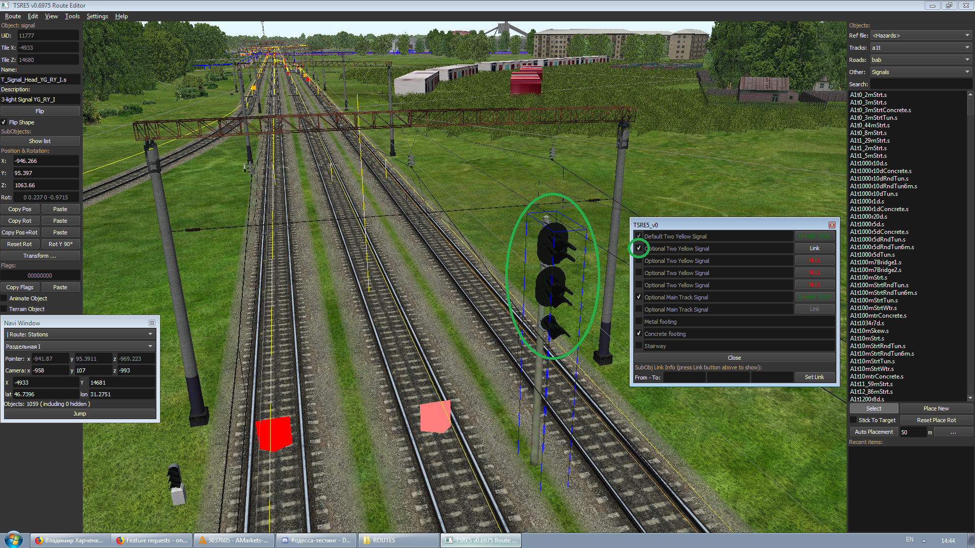

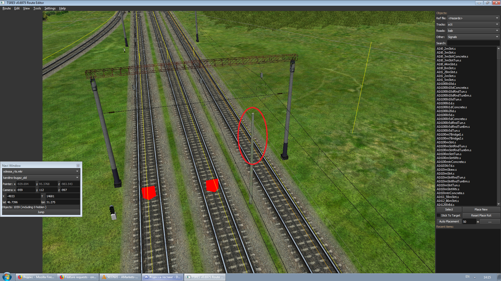

The problem is that the signal heads (and other things connected with signals like ladders) are only seen in TSRE when you try to link them (tick the box) - see the attached files. Can you make an option in "View" directory of TSRE to see the signal heads even if you dont work with them at the moment?
I am working on the route with my partner and his duty is to place signals. I cant check whether he placed the signals in the right way and direction or he made a mistake cause i can't see the signal heads while just browsing the route in TSRE.

I am using the russian signal system created by Timas (most popular russian signals for MSTS). In MSRE the signal heads are seen both in the game and in the route editor. In TSRE they are seen in the game, but in the editor they only seen when you check the box while linking.
