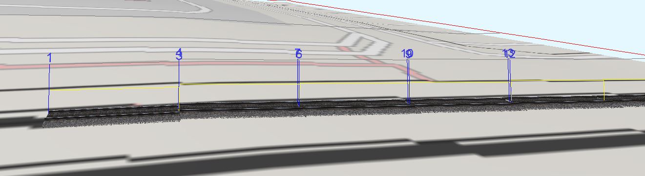

I'm a complete newbie to route editing...I've been able to create a new route, load the map for that route tile, load the HGT data for that tile..starting laying track...and that's where I have a couple of questions...
#1. In the attached photo you can see track sections. I "set rotation to terrain","Set position to terrain", Adjusted rotation so "tracks alight" however you can see the elevation changes between sections....I'm using 10m sections.. is solution just smaller sections...?

Hi Amtrak
I don't know anything about the "set position/rotation to terrain". I don't even know where to find them.
Place your first piece of track and rotate it to the correct direction using the "R" key followed by number 4 or 6 .
While the track is selected press "F" and the terrain will conform to the track.
Place your second track piece and this should snap to the first piece. Again F will adjust the terrain.
If you wish to adjust the gradient do this in the panel on the left BEFORE you have the tdb lines showing on the track.
Under "Elevation" there are a number of different ways of setting the gradient, I use the default 0/00.
I find that changing this by 5 for each 10m length of track gives a fairly smooth transition.
(Note that TSRE will change your value slightly unless you enter 5.00 10.00 15.00 etc.
You should find that long sections of track join up correctly.
