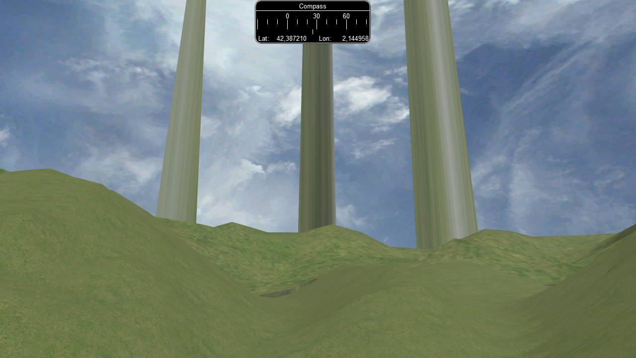

Garry, sorry I'm late. I've been busy with other things for several days now.
There really are many, in various points and directions. If I deactivate the Distant Mountains they will disappear, but I hope the image will work!

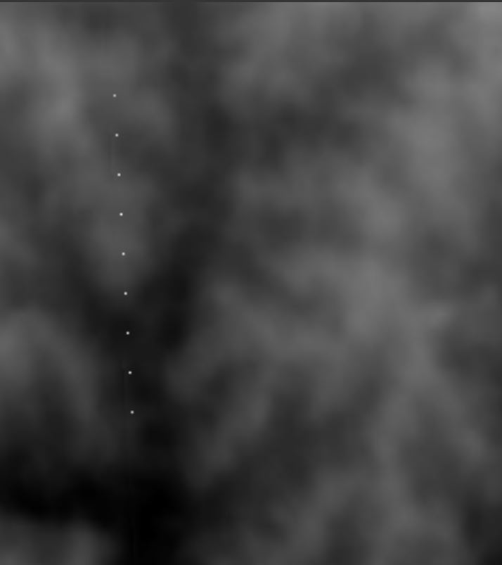

I ran into this while working on some tiles in Northeast Kansas.
Took a closer look at the hgt file and saw this.
Looks like it ran off of the film sprocket.
Easy enough to fix.
Randy

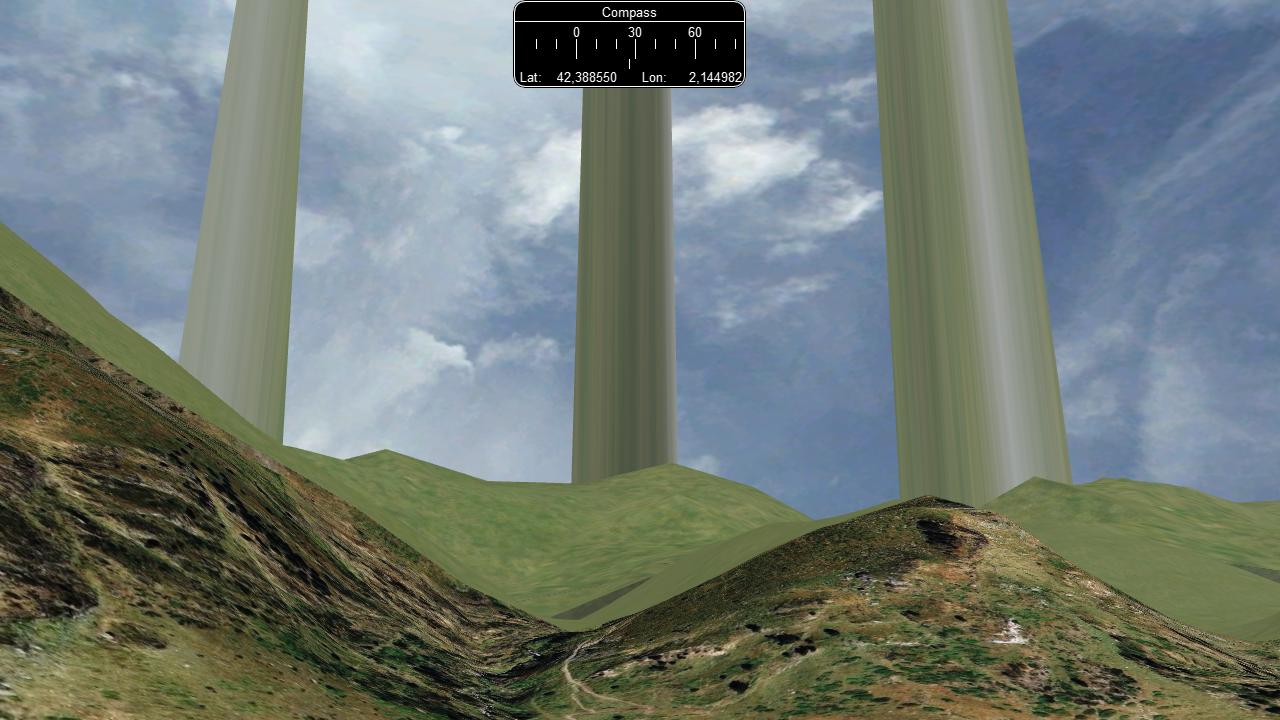

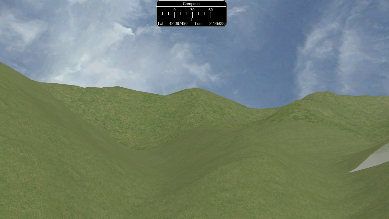

I hope I have attached my Tiles and LoTiles folders, and also an OpenRails screenshot from a similar position to your previous image.
All the height files were generated using TSRE

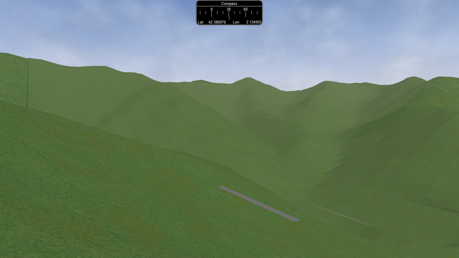

Now I have opened the Path with OR and Bingo! the spikes have disappeared:
Open Rails 2020-09-13 07-32-02.png (1.07 MiB) Viewed 27920 times
In the image, at right, there are other new problems with the terrain, which we hope will be possible to solve. I have lost all the modifications of the terrain, but at least I will be able to start everything again in good conditions. It is clear that the problem was some old files coming, for sure, from the time when it was necessary to use DEMEX to generate the distant mountains.
Thank you very much for your help. Anything, here I am!

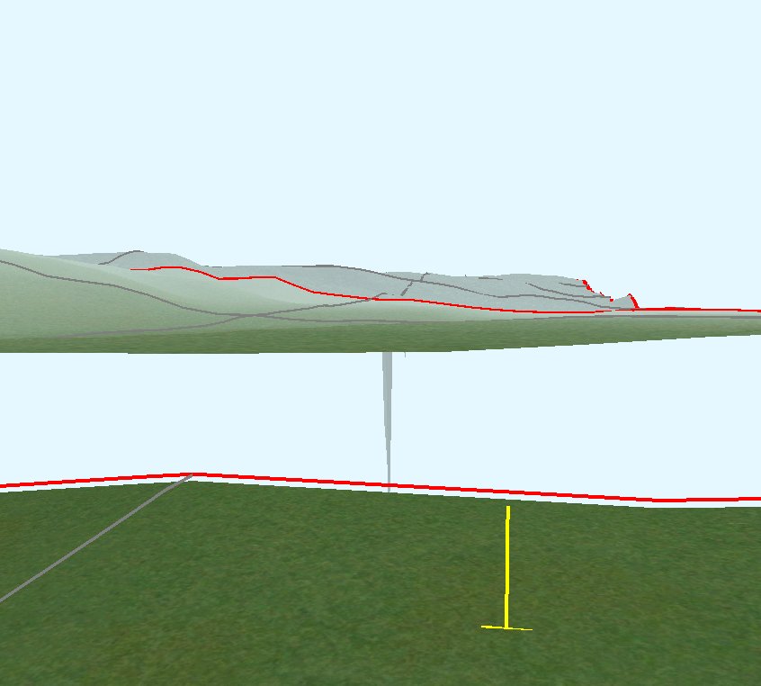

I am pleased that things are going well. The white gap in your image is probably caused by the tile for that region not having been generated. This is the reason that you can see below ground level in this image from my Swiss route. You will also notice that I have underground spikes, which cause problems only when they are close to the track. They are easy to remove, just place a track or road section beside it, rotate it until it projects over the dip (or into the spike). Press F to get the ground to track level. You may have to repeat this around the problem area until it is all level.
