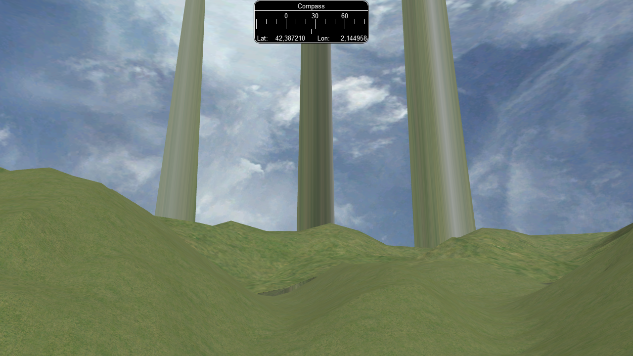

Hello!
Garry, sorry I'm late. I've been busy with other things for several days now.
There really are many, in various points and directions. If I deactivate the Distant Mountains they will disappear, but I hope the image will work!
Open Rails 2020-09-08 12-35-19.png (1.21 MiB) Viewed 27987 times
This is strange!
Unfortunately I am not able to post screenshots at the moment, UKTrainsim is under a major repair.
I have gone to the location shown on your picture. Both Google Earth and my route place this high on the mountain side, 2370m, to the south west of Nuria.
Looking at 30 degrees as you are, I see no spikes, and I have both standard and distant terrain in this direction until I reach latitude 43 degrees, I have not downloaded the height files here.
Is it possible for you to post on your website, your copies of the terrain folders --- tiles ---- lo_tiles. Then I can have another look.
For your information I generated all my terrain using the .hgt files from your link, and then using TSRE.

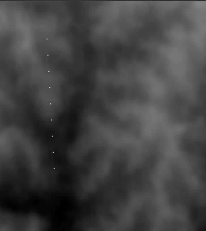

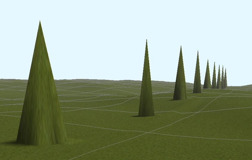

I ran into this while working on some tiles in Northeast Kansas.
Took a closer look at the hgt file and saw this.
Looks like it ran off of the film sprocket.
Easy enough to fix.

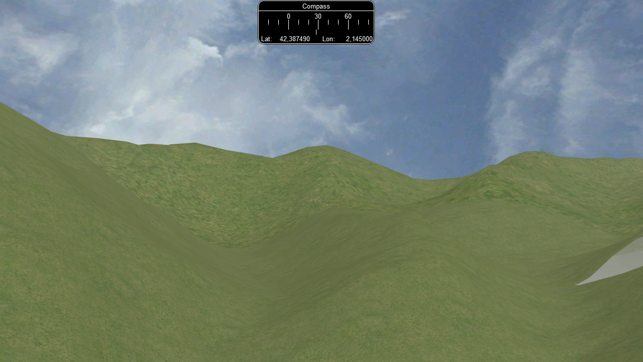

I hope I have attached my Tiles and LoTiles folders, and also an OpenRails screenshot from a similar position to your previous image.
All the height files were generated using TSRE

Thank you very much Garrry, I downloaded the files and replaced them with the ones with the same name, although there are many more in my folder.
The result is the same as before.
It is possible that the problem is in one of the previous files. I don't know whether to try deleting them all and putting only these of yours, Garry.
Right now the look with the new files is this:
Open Rails 2020-09-13 07-06-18.png (1 MiB) Viewed 27901 times
The work I had already done has been lost, but it would be useless to continue anything without first solving this.

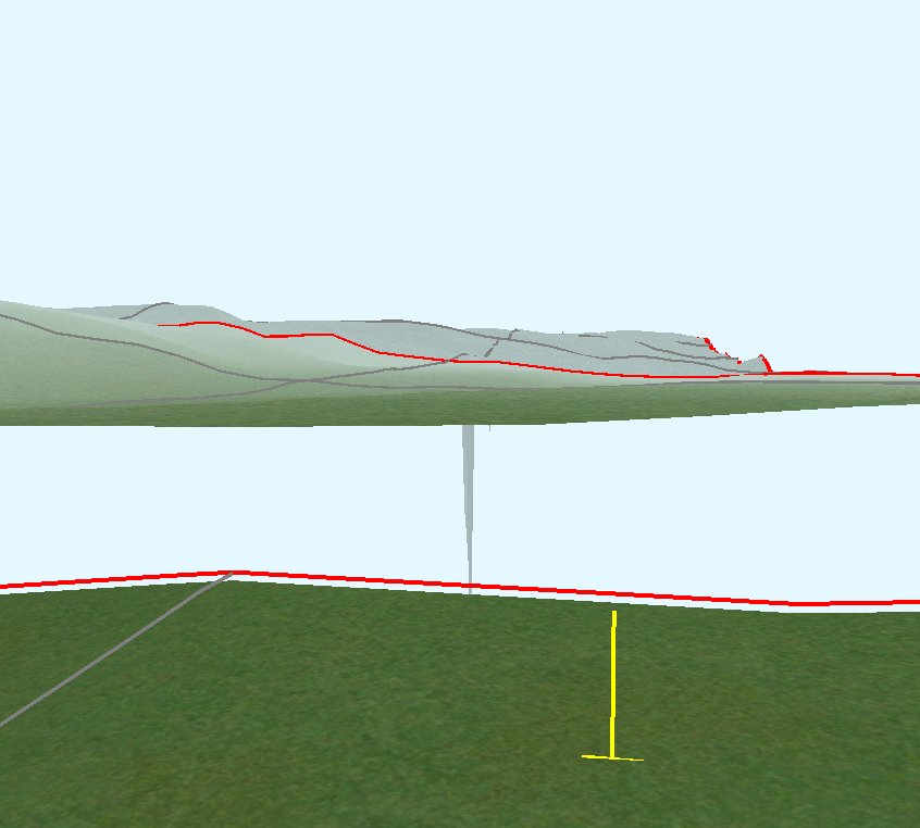

I am pleased that things are going well. The white gap in your image is probably caused by the tile for that region not having been generated. This is the reason that you can see below ground level in this image from my Swiss route. You will also notice that I have underground spikes, which cause problems only when they are close to the track. They are easy to remove, just place a track or road section beside it, rotate it until it projects over the dip (or into the spike). Press F to get the ground to track level. You may have to repeat this around the problem area until it is all level.
I notice that your route is a rack railway. Can I ask how you are going to get the trains to run up the steep gradient. I build a route from Lucerne to Engelberg which in reality is a rack railway. I cheated and used RouteRiter to decrease the height of the area around Engelberg.
