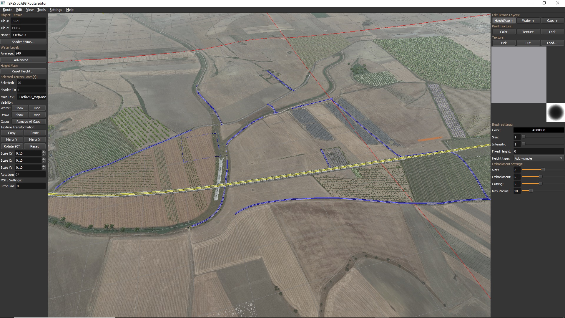

Great Goku! I have another PC with discreet GPU Nvidia Gtx1060-6GB and here the TSRE/OR installation works wonders. On the new PC with i5-8600K I still use the Intel UHD-630 integrated GPU. I thought that among the Win10 updates came down Intel drivers for GPUs. But that's not the case! The driver was vers. 24.20.100.6292-27/08/2018. Now I updated the driver and came down the vers. 26.20.100.7584-26/11/2019. Now TSRE works. Thank you very much!
