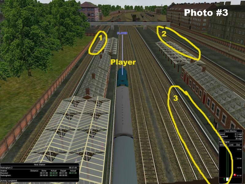

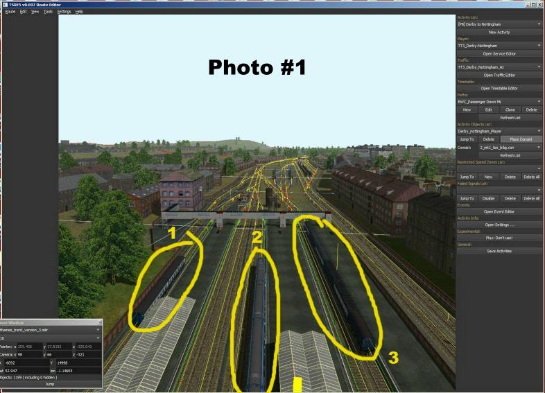

I have put 3 static consist in the area of Nottingham station, and they appear fine with no error messages in the Consist Editor or Route Editor as shown in photo #1.

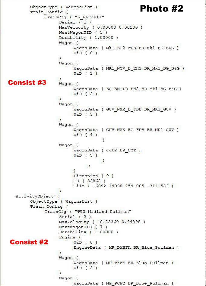

The 3 consists are recorded in the ACT file as in photo #2
When I get to Nottingham station where the activity ends, NONE of the 3 consist are there in photo #3
This is making me nuts that the consist will not appear and I can not figure out why??? Any help or cure for this is appreciated.

Thanks for more info.
Does these consists are present in TSRE after save and reload?
If yes, then OR log would be useful.
