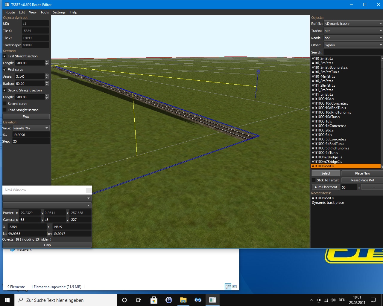

I have made a Dynatrack 200m strait, curve 50m Radius, 180 Grad, 200m Strait, elevation 20 o/oo.
On the Picture you see the 200m strait-Part at the end of the Dynatrack.
The yellow line is rising continuously, but the Track rise only until the half part of the curve, then it is descending until the ground at the end of the track.
I think, with the calculation for the Dynatrack-Shape something is going wrong, when the Dynatrack has an Elevation.

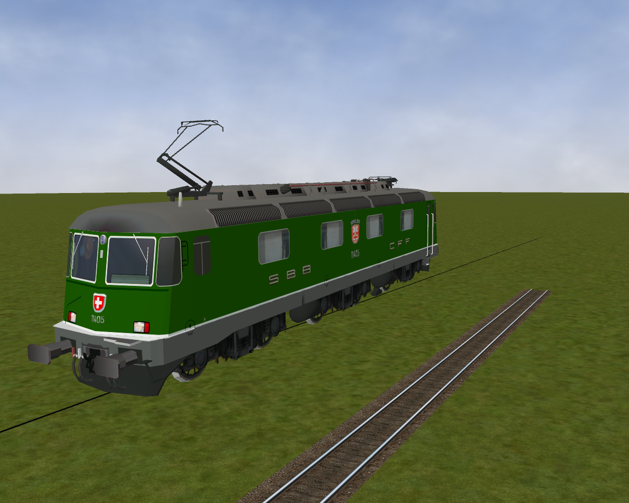

Goku wrote: 16 Feb 2021, 22:03 If angle is positive, start from the other side. I don't know if that helps with anything, but you can try and check.
But also in OR the Track is showing as in TSRE5, but the loco is following th coninuosly rising yellowline.
In the Picture the Loco is at the end of the Dynatrack.
