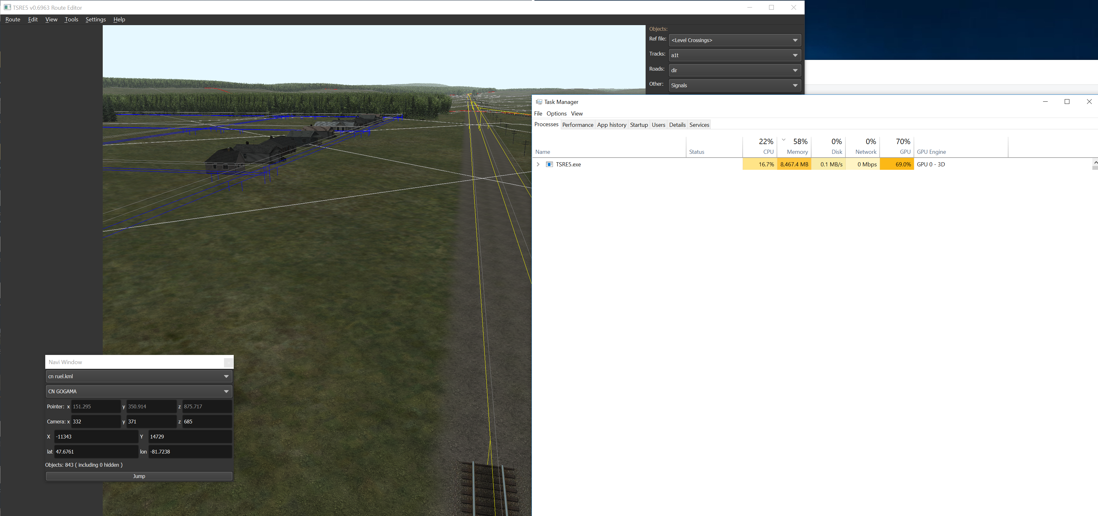

It seems to be most apparent on the routes with dense forest objects. The whole application grinds to a halt while It tries to load the contents of the tile. While a given tile might only be 800 objects, it would contain dense forest objects. One the routes I have which have little to no forest objects, performance or memory consumption isn't an issue. I'm no programming expert, but is there any chance the rendering of the forest objects isn't being instanced and instead hogging memory? See attached image.

I made a dense forest but don't see anything wrong.
Could you send me the route with this bug?
